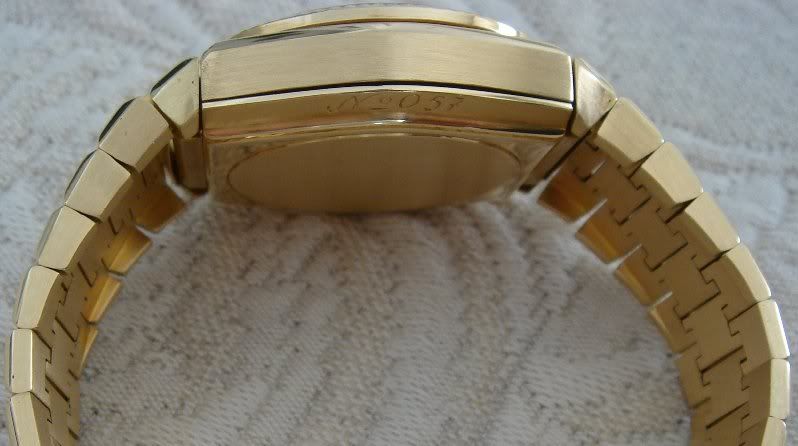

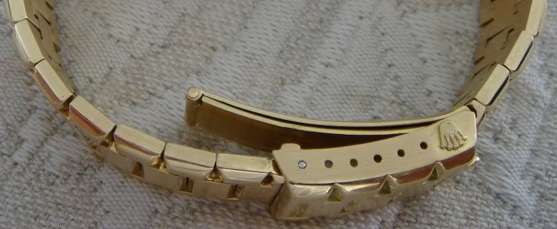

    Original von Prof. Rolex
    One further remark to the bracelets: Due to my knowledge there were two versions. The first batch of approx. hundred 5100 had a "less weight" bracelet (the elements were much thinner and formed like an “U”) and had a folded clasp (not concealed) with a rolex-crown at the side (!), from approx. serial No. 100 upwards the bracelet was like shown in your description.
    In addition to my a.m. remark, please find following two pictures of a bracelet from the first batch (Ref. 5100 No. 57):
    (Source: unfortunately unknown)
    Best Regards
    Matthias
