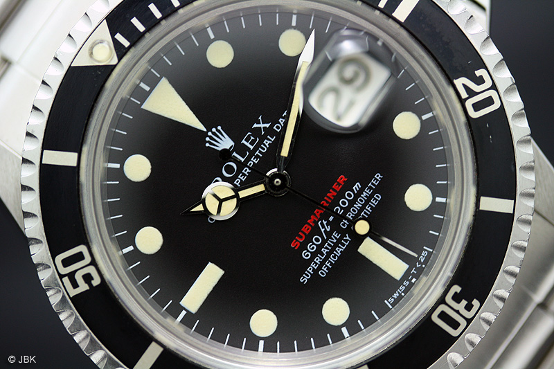

    My contribution to the thread:
    John B. Holbrook, II
    eee
    beautiful watches.
