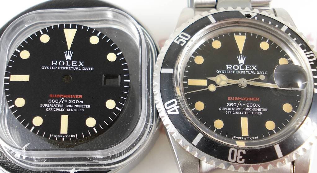

    dial totaly fake, watch ok:
    bracelet offered "very good condition" but terrible in real:
    original left/fake right:

    What is the problem with the dial? Is it a real red sub dial which has been relumed. Or is the dial totally fake and why? I know nothing about it, just want to know.

    May I ask the same question as Andreas: Would you please give us more information about the dials?

    hey guys, its one of the best fakes i have seen in the past. was on pics not to see as i bought. compare both dials on pic. all letters are wrong, coronet is wrong, far left "L" in ROLEX, "6" in 660 feet is wrong, all serifes are wrong, SUBMARINER to far from 660ft = 200m, indexes to close on minuterie

    Thank you Ralph for enlightening us. When I see the direct comparison I can also see the difference in the dials. This is really bad. Take a ****ed up watch with an even more ****ed up watchband and put a fake dial in and .. voila we have a collectors dream. A watch with "history" .. Very bad indeed. Even worse, because they certainly knew what they were doing. I hope you can cause them enough trouble so they gladly take that crap back ..
