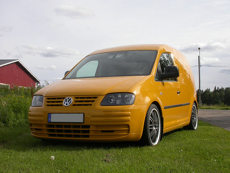

    I just put my new van together>>>

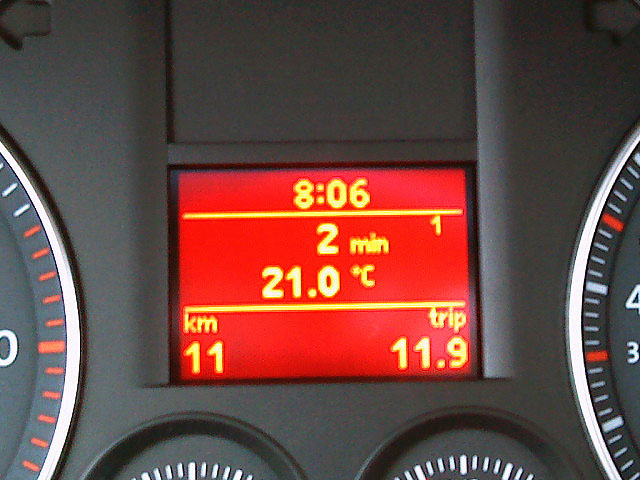

    11 kilometers at the odo, this should be fun.

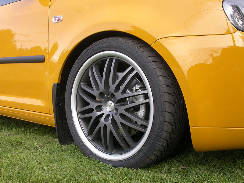

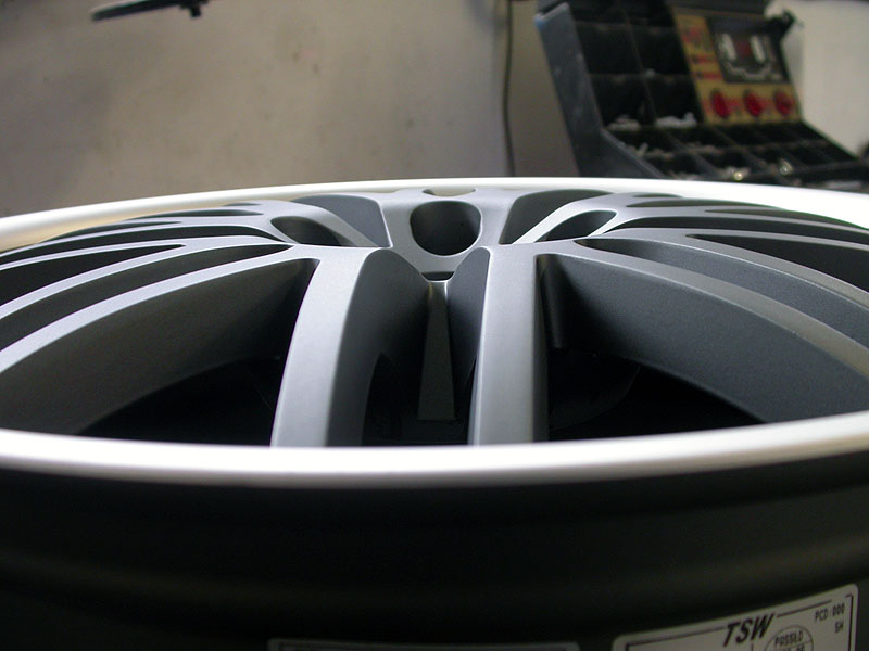

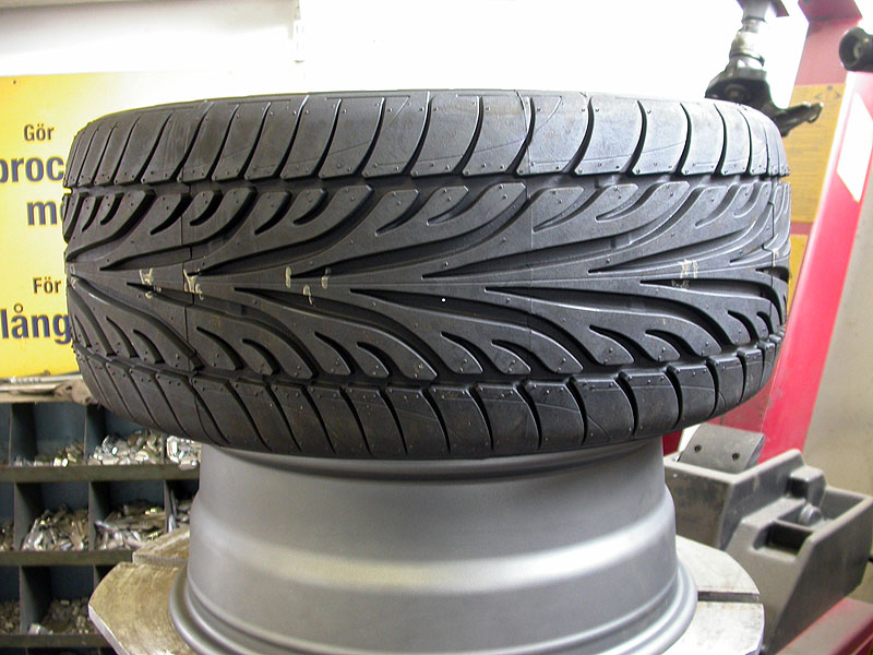

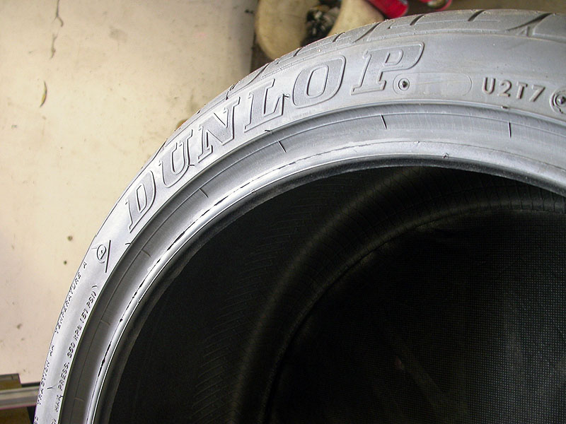

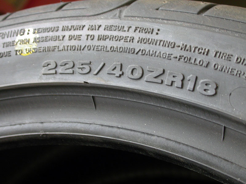

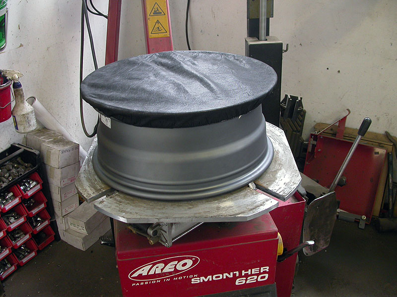

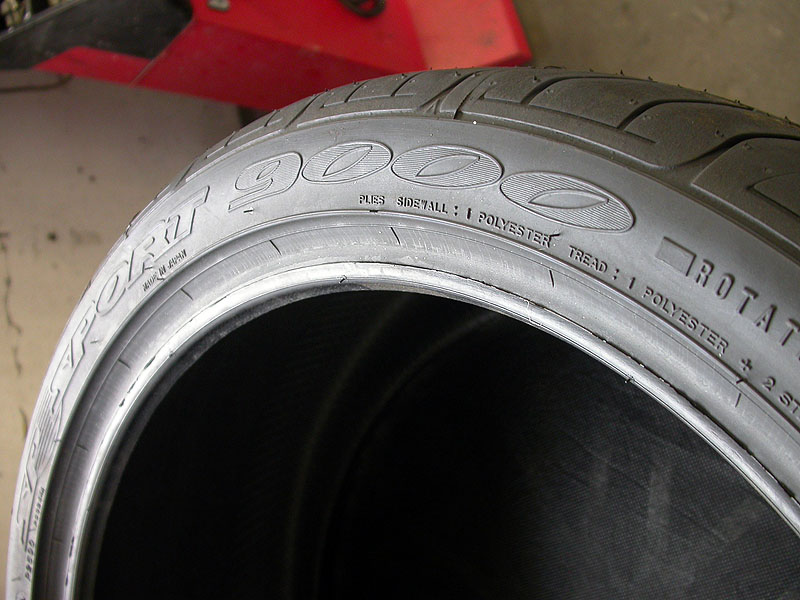

    Rims and tires is here.
    Just a teaser.

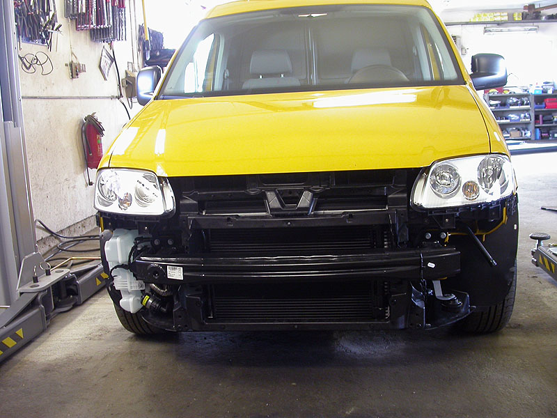

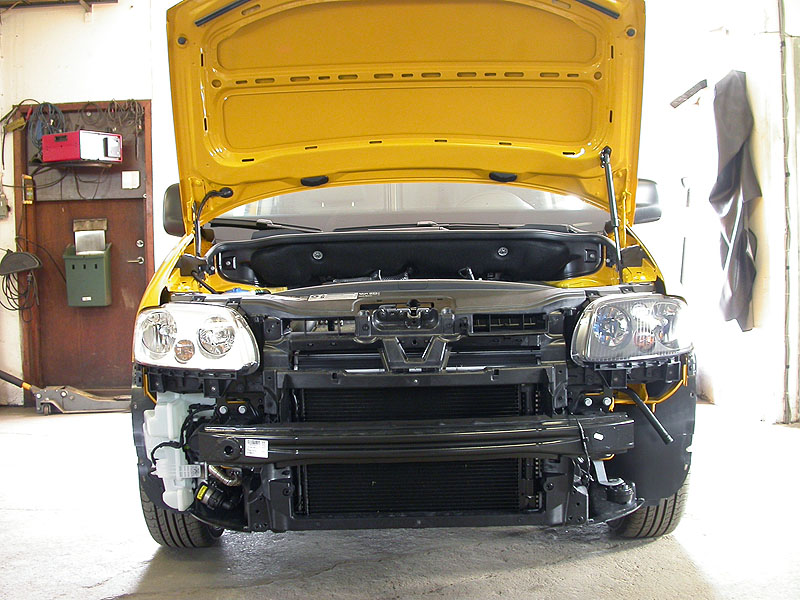

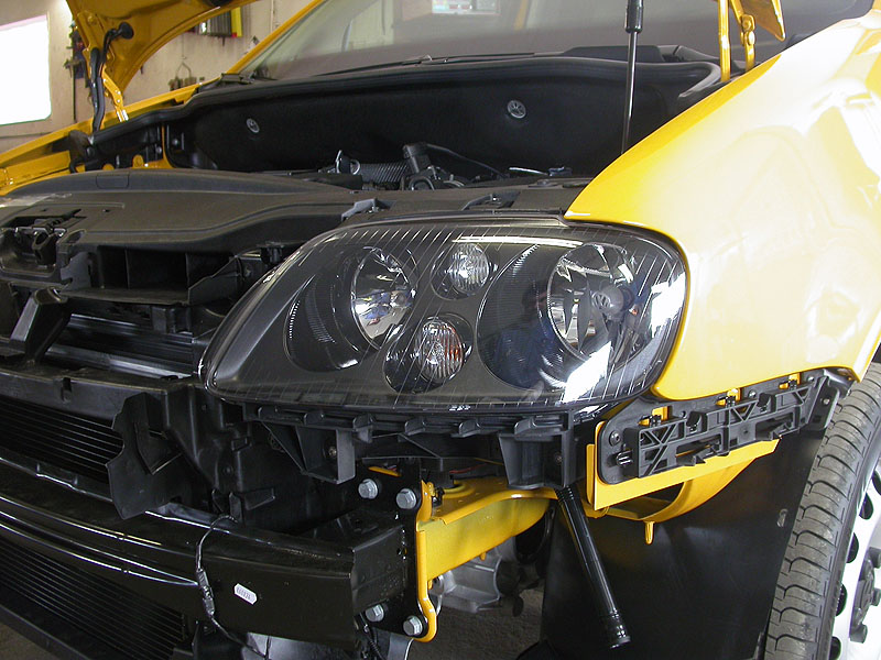

    I just get rid of things that I not need.
    A lot of things to pull off.

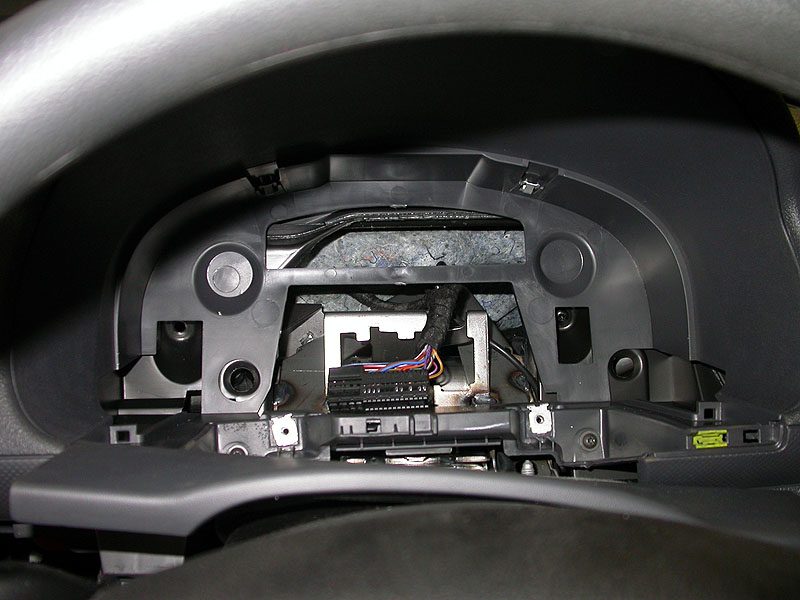

    Some electrical work.
    There it is.

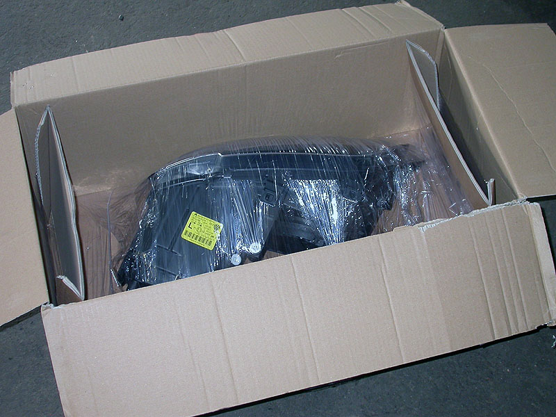

    Then I got a package.
    Mmmm, me like.

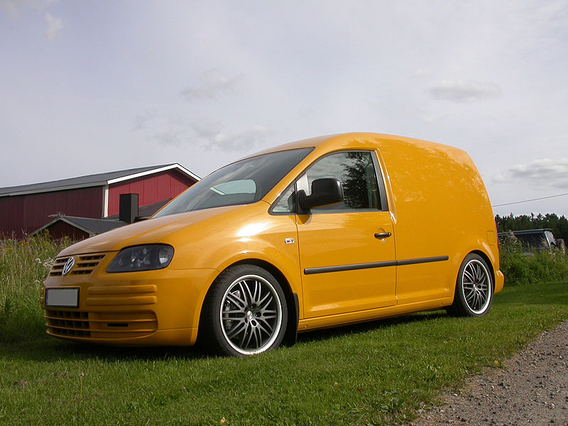

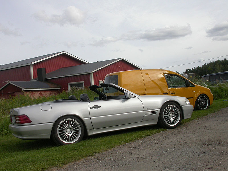

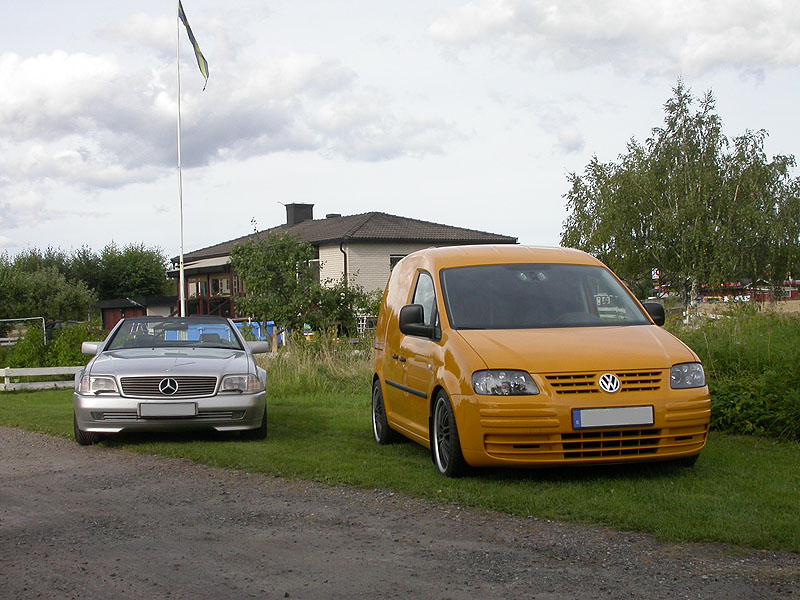

    The first one on location.
    Looks great beside the yellow.
    The orginal.
    Nicer.
    Way to yellow.
    Me like.

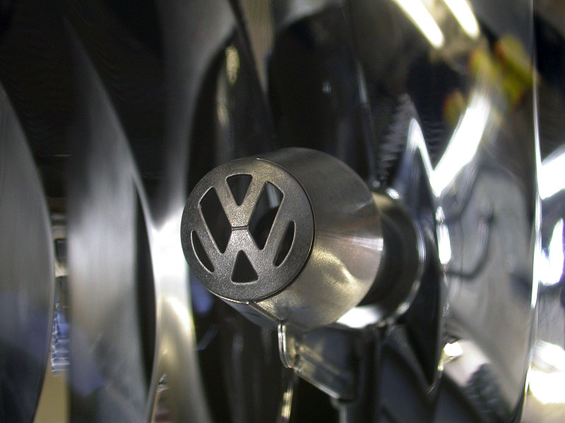

    Notice the VW logo.

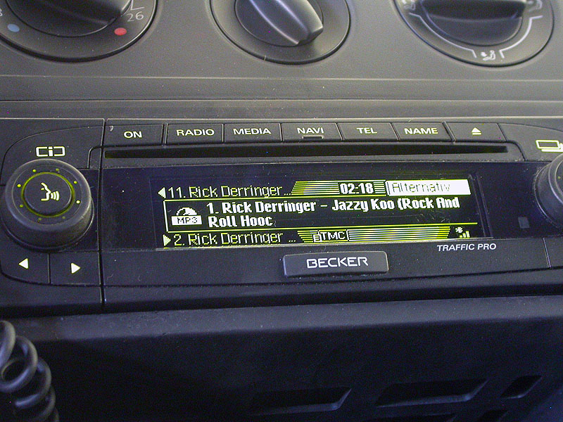

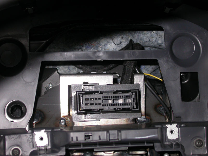

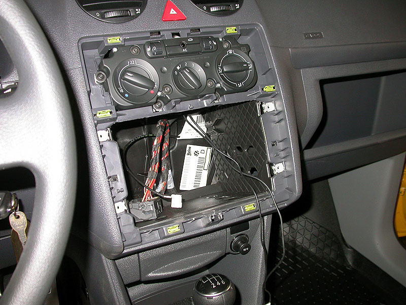

    Time to get inside.
    Here will the CD and navi be.
    Out with the dashboard.

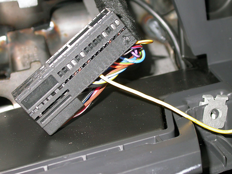

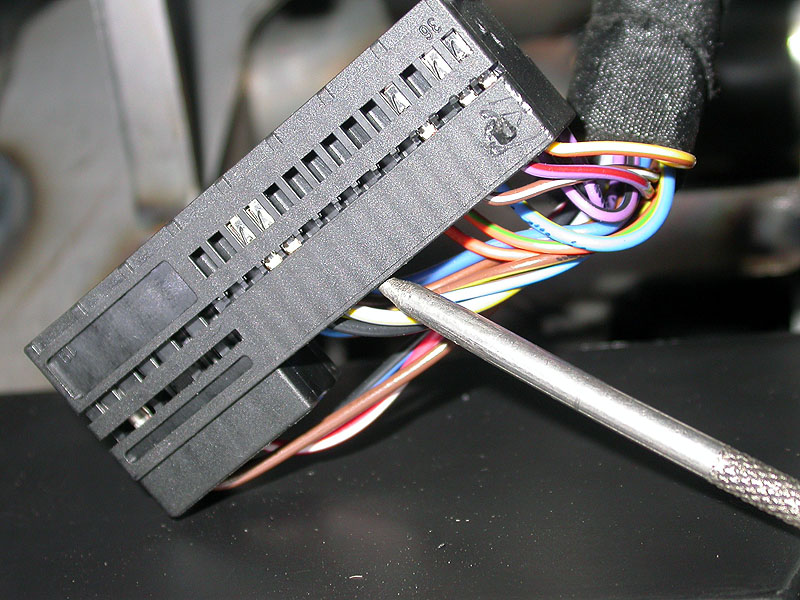

    Then I will locate where the pulse cable to the navi should be.
    Then I put it in.
    Ready to rock.

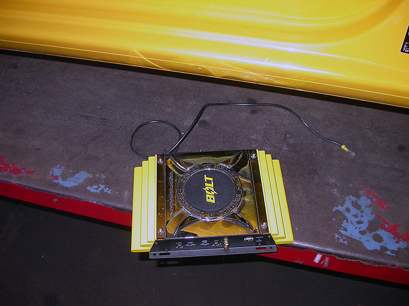

    A amp in matching color. LOL

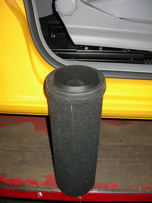

    Behind the seat will be fine.
    And the subwoofer.
    Melting with the interior.
    Sounds like a dream. Bluetooth for the phone too.

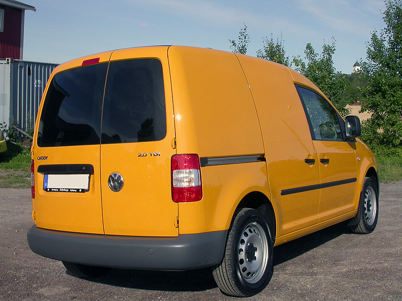

    Nice, the painter was here.
    This is not nice.

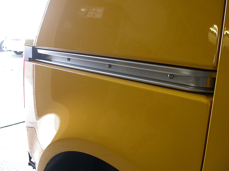

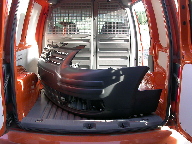

    So I order a rail from the version with glasses.
    And the cover from the painter.
    A lot better IMHO.

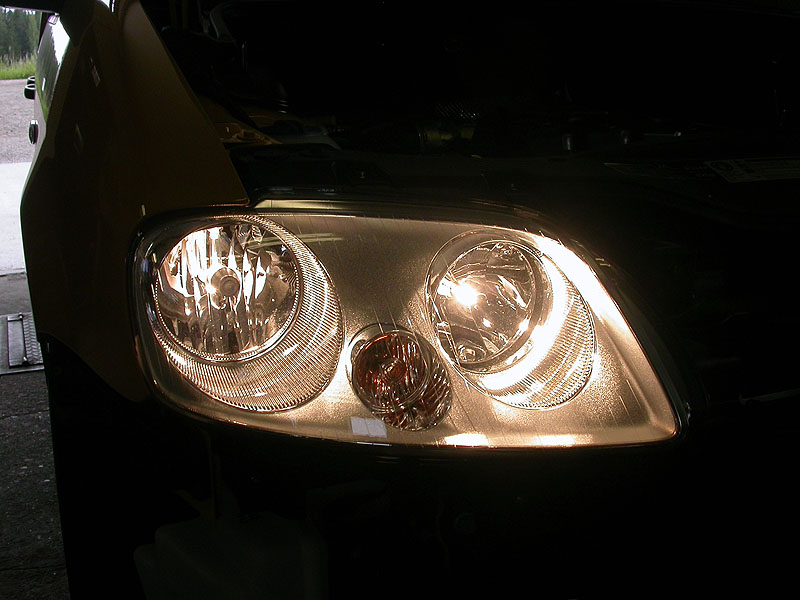

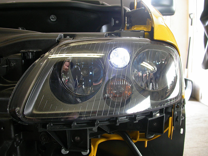

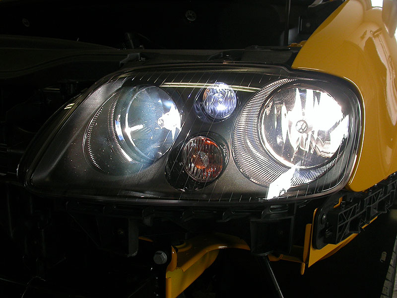

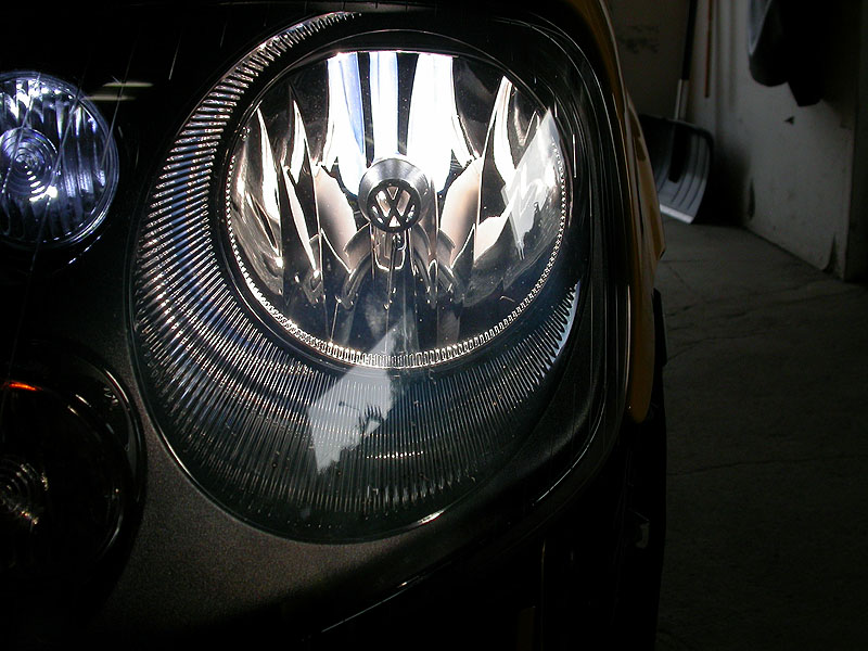

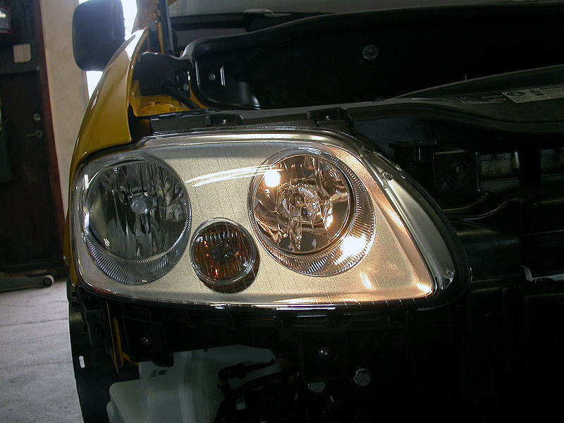

    Then I put on extra lights inside the car.
    Xenon bulbs so it will be interesting to see how it works in the dark.

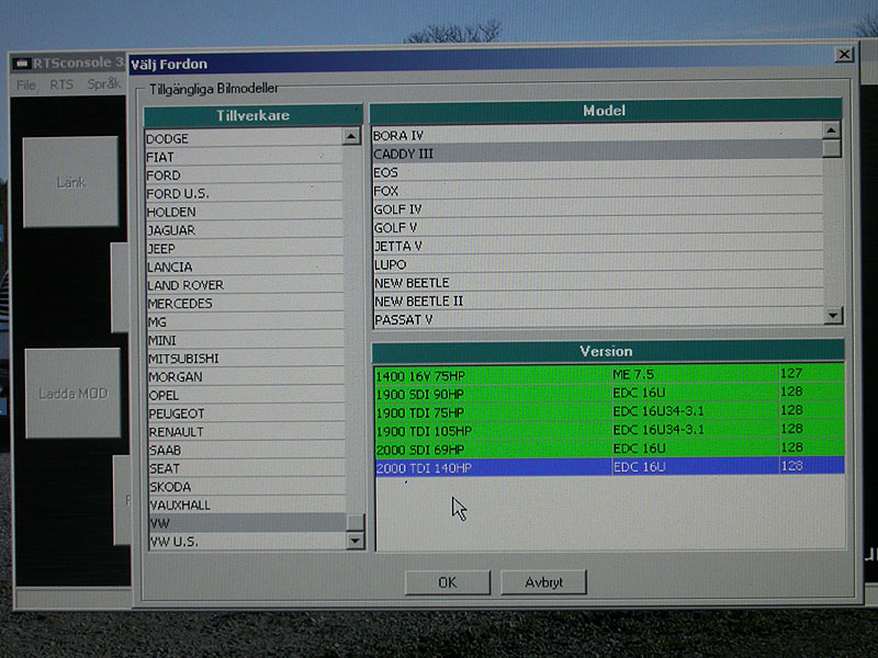

    Choose car and 10 minutes later I have add 40 hp's.

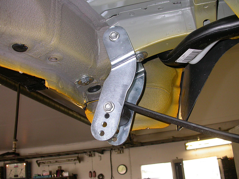

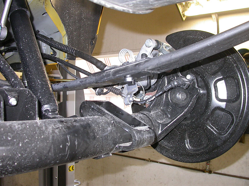

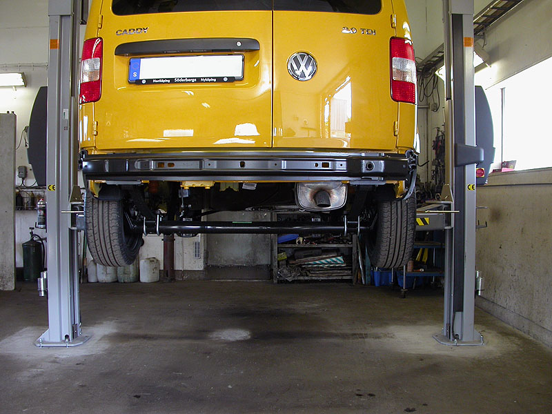

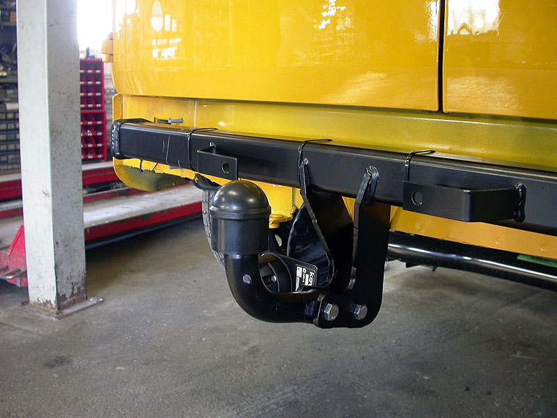

    Something is wrong here, the leaf spring is at the wrong side of the axle.
    So I have to do something about it.
    Nice to work with, no rust.
    Now the leaf springs are at the front of the axle.
    And here we are at the right side with them.
    Adjustable too.
    It's going in the right direction.
    Shock absorbers in place too.

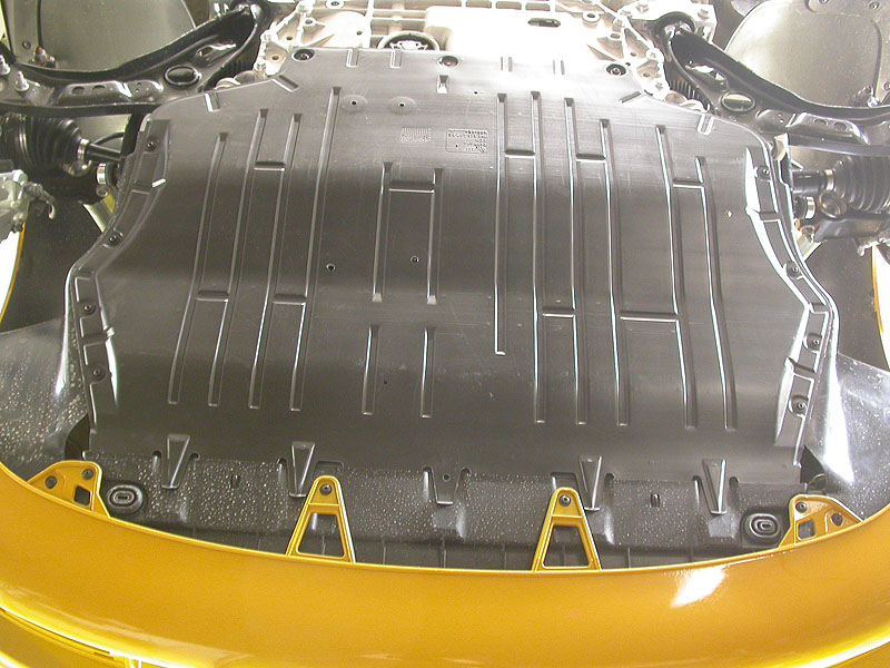

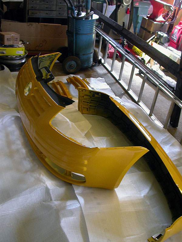

    And the painted bumper.
    So now the rear is finish.

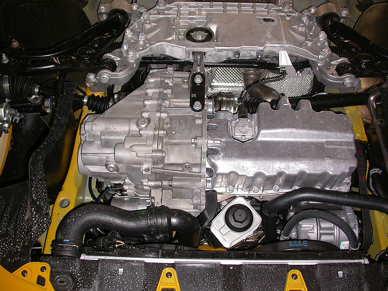

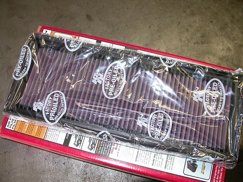

    A quality filter is never wrong.
    Preoiled and ready.

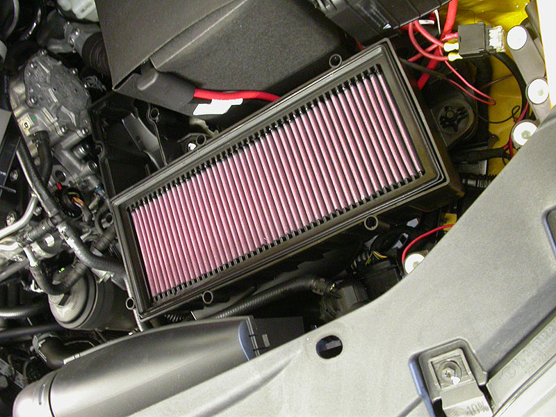

    In place.

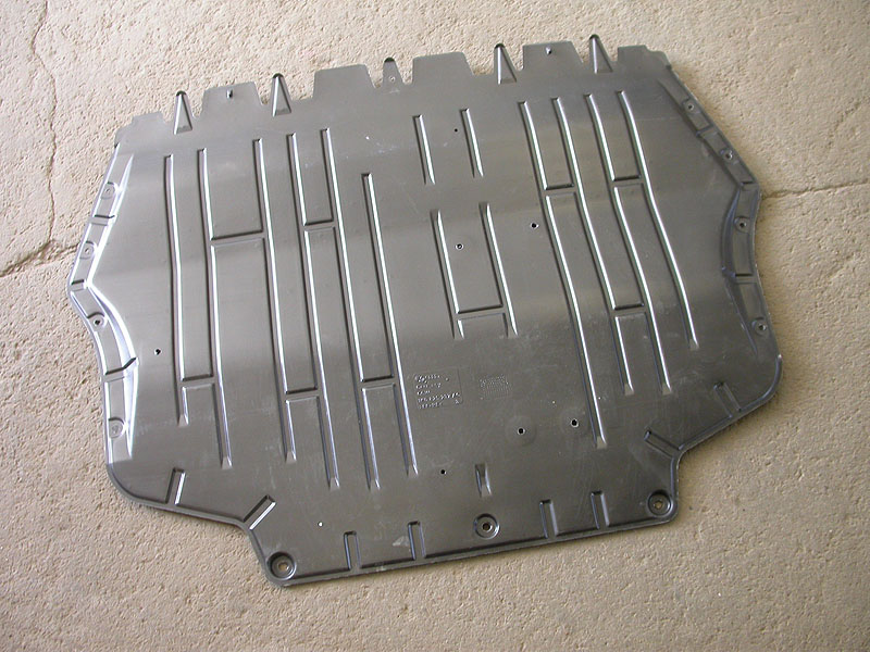

    Damn, now they have stop deliver the car with the engine cover.
    So I have to buy one.
    No dirt and no roadnoise.

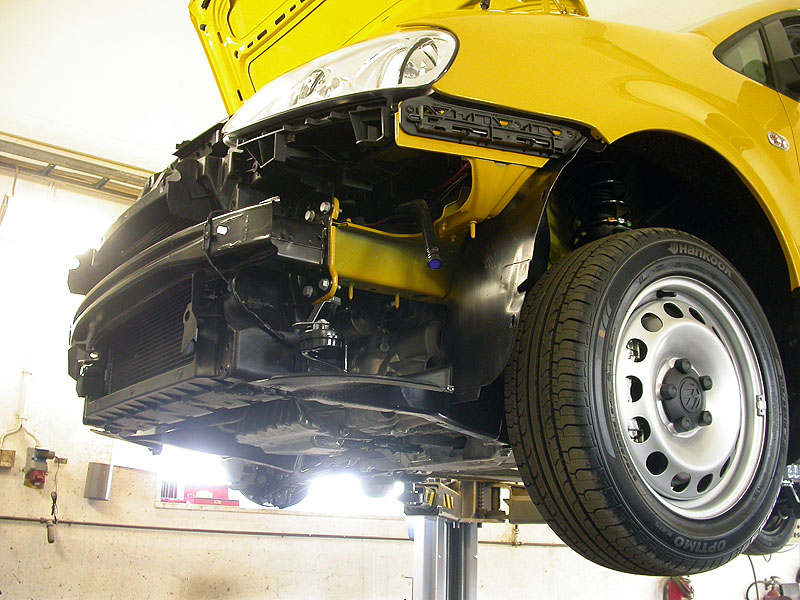

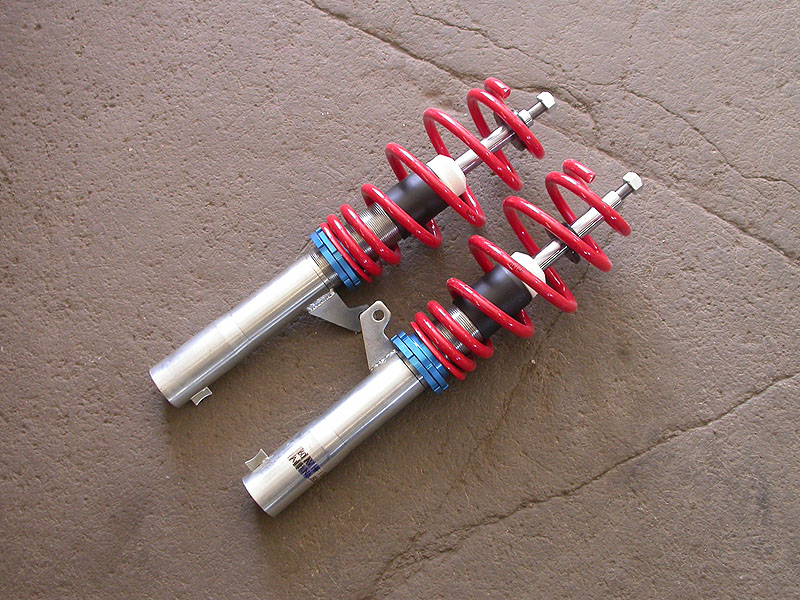

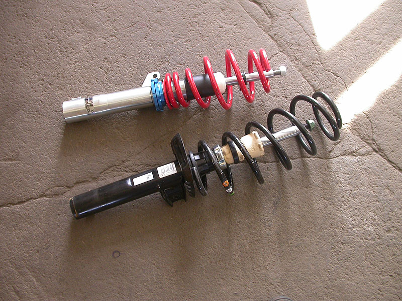

    Now we will have some more fun.

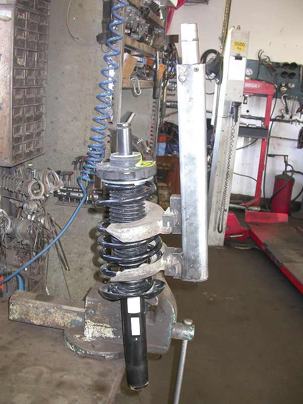

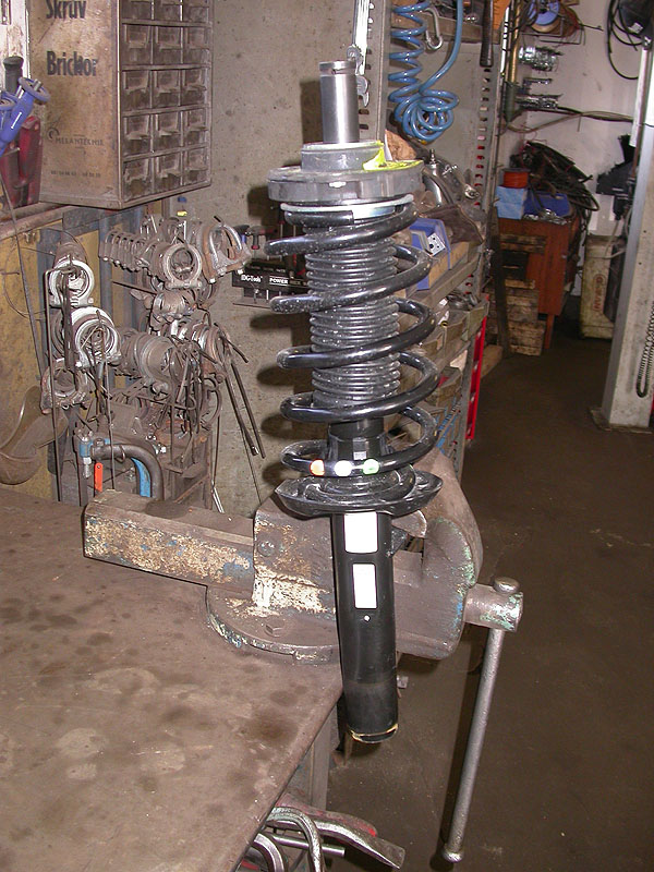

    This one have to go.
    I need the top bearing.
    So I have to get it.
    It's a little difference.

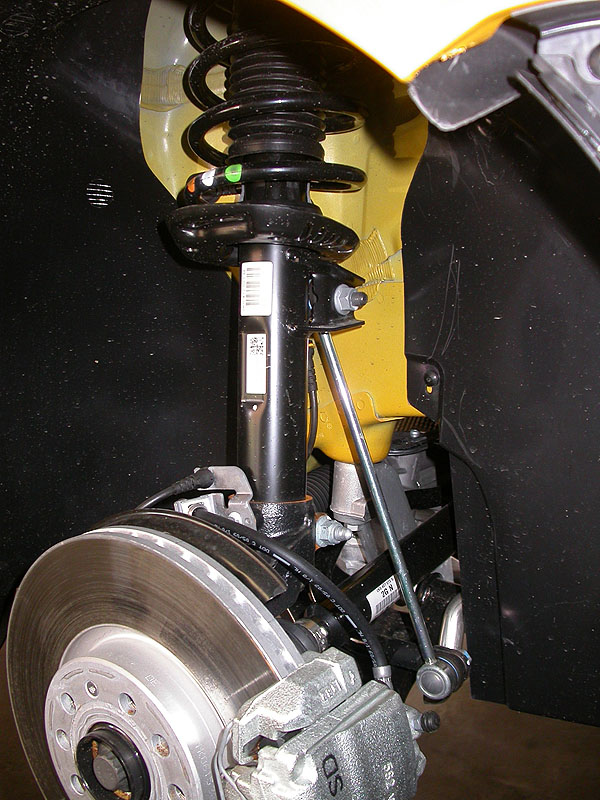

    I start at the bottom.
    And there we hit the ground.
    I'm very satisfied with the result.
    Or was it better before?

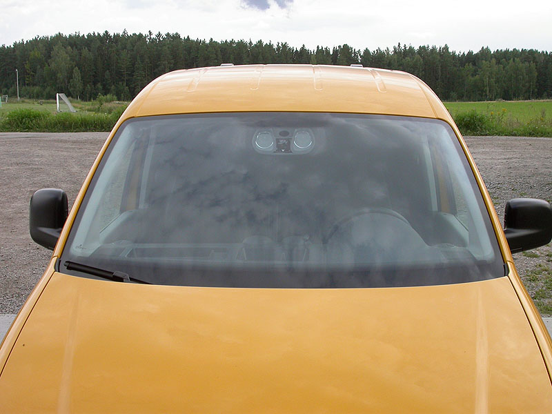

    I have always been weak for low cars.
    I hope you find this interesting.
    Jocke
